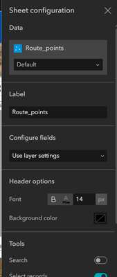

Is there any configuration within the Experience that might be reordering the order of your columns or are we using the Layer default?
If it is default then do we see the same behaviour in the Map Viewer or within a new Experience?

@David_McRitchie - All of the layers are set to "default" and this behavior continues across multiple maps created from varying, but related data.
When I pull this layer up in Map Viewer and view the table, all Fields appear and are arranged in the expected order.
