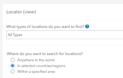

You can create a locator view to limit searches within a specific region, or you can publish your own locator service.
