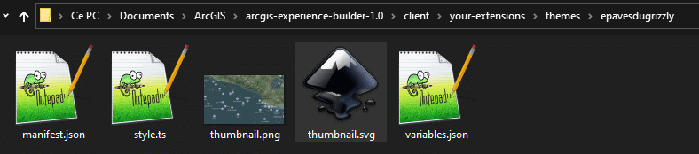

I have these files in a folder called "epavesdugrizzly":
• manifest.json
• style.ts
• variables.json
Here is the content of the manifest.json file:

I copied these files to this folder:
arcgis-experience-builder-1.0 \ client \ your-extensions \ themes
I tried to copy the epavesdugrizzly folder here:
arcgis-experience-builder-1.0 \ client \ dist \ themes

The location of the theme needs to be copied in the client/your-extensions/themes folder. The dist folder is the compiled code. If your client service is running, then restart the service and refresh your browser. I was able to take your manifest.json and get it to show up in the theme listing, with one caveat, I removed the font-weight so I could see the label. Let me know if you have any other questions.

I was copy epavesdugrizzly folder in client/your-extensions/themes folder , but I can't see my theme.

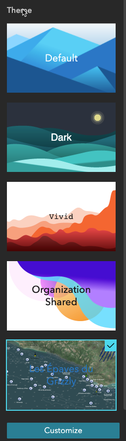

Yes, I can see it. Did you restart your client service? Do you see your theme listed in there? custom theme

Cool ! It's OK for me, now.
