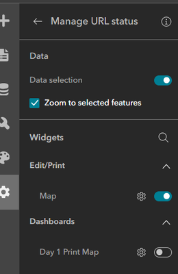

I'd like to revisit this question again. There's been a few upgrades to Experience Builder since I last posted this including enhancements to URL parameters. Am I able to filter data sources easily like I can in dashboards using any of the below?
Do I need to use data_s parameters like this?
https://experience.arcgis.com/experience/<AppId>#map_1=layer_visibility:%7B%22widget_1-dataSource_1%22%3A%7B%22widget_1-dataSource_1-187938b7328-layer-2%22%3Afalse%7D%2C%22widget_1-dataSource_4%22%3A%7B%22widget_1-dataSource_4-18a690b433a-layer-4%22%3Afalse%7D%7D

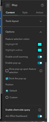

I am focused on the map widget and then setting the action/triggers to the other widgets from there.
I had a look through:
