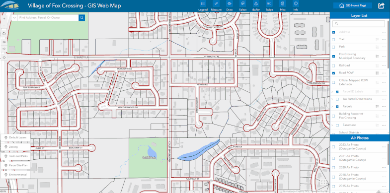

I'm still experiencing this issue with experience builder. Zooming in with the mouse wheel zooms at a different step interval than zooming with the +/- buttons in the map. This is only really a problem because I want the print tool to use the zoom levels I had setup for my basemap, so it prints at scales that can be nicely measured off of (1:1200, 1 inch=100 feet). See the attached GIF to see how the zoom levels differ if you are using the mouse or if you are using the +/- buttons on the map. Is there a setting in experience builder to force certain zoom levels?
