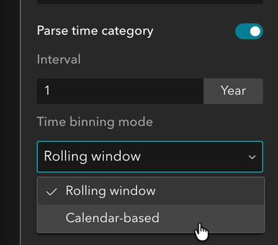

Wei_Ying
It was already supported in AGOL October 2025 release. For Enterprise would be in 12.1.
The "Calendar-base" option set the calendar date for binning
AngusvonPrott
Hello @Wei_Ying ,
I have seen that option, and perhaps I am using it wrong, but what I am experiencing is that even when Calendar-based is set, my dates shift. For example, my complete data set covers every month for a few years down to the day; each date bin set to one month and is initially reflected in the chart as 01/01/24 - 01/02/24, this is the expected time binning. However when I filter my data and the earliest record for that initial month is the 4th day of that first month the intervals change to 04/01/24 - 04/02/24. This has a cascading effect when we are looking at years worth of data. This causes us issues when creating an insights dashboard that shows monthly change and trends using a combination of charts and dynamic texts in conjunction with filtering. When we are showing summarised monthly data, it is not reflected in the charts, they are missing days at the start of the month and extending into the next month, thus contradicting the dynamic text.
