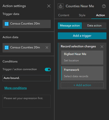

Thanks! I would like to trigger the popup from selection within the nearme widget, is that possible through message actions? As of right now I have Near Me -> Set Location under the map actions and Framework -> Select data records under the Near me actions. Unfortunately it is not working the way that I want it to quite yet

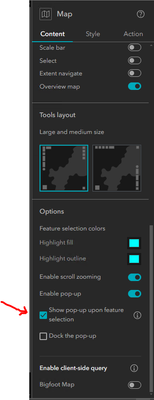

In Map Settings Panel, turn on Show Popup Upon Feature Selection. Does this do what you want?
GIS Developer
City of Arlington, Texas
sophered
I do have that turned on, however, it is not working the way that I want it to. Upon selection within the nearme widget, it does not toggle the popup. Is it possibly an issue with my Message Actions?

Maybe try a Record Selection Changes>Framework>Select Data Records Action in your Near Me Widget.

Unfortunately I have those data actions in there already!  As of right now I have Near Me -> Set Location under the map actions and Framework -> Select data records under the Near me actions.
