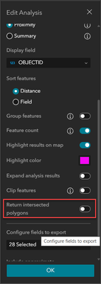

AzizaParveen1
@ChaitaliChandani
In your analysis configuration, do you have this option enabled? If it is, could you try disabling it and see if this fixes your issue? This particular setting in Proximity analysis is designed to return intersected line or polygon feature only.

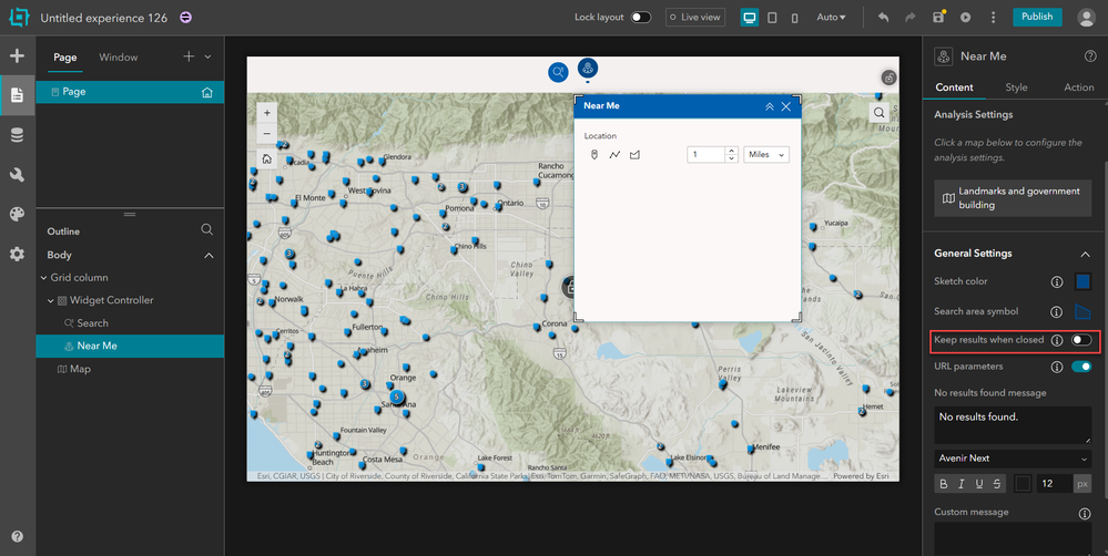

I have one more question regarding the Near Me tool. When the Near Me widget is closed, I would like it to reset automatically. Additionally, when the address/search location is changed, I need the Near Me results and settings to reset to the default search distance rather than retaining the previous search criteria.Thanks a lot for your help!
AzizaParveen1
Hi @ChaitaliChandani ,
To reset Near Me results you can turn this "Keep results when closed" setting off from the General settings tab in Near Me, it should reset the results.
Only thing I noticed while testing this is, Map is not going back to its initial zoom state, will check it from our side. I will update you once I know more about this issue.
