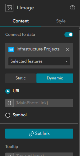

This one might not have an actual Solution right now, so consider this a discussion: How are you applying alt text to images in Experience Builder that get dynamically rendered from either attachments or links, etc? An example: I have an app where selecting a feature on the page triggers an Image widget to show an photo from a link.
Dynamically populating alt text is difficult - alt text should be an actual description of what appears in the image. The best thing I can do right now is something like this:
Technically, it meets ADA standards but it's pretty unsatisfying and less than helpful for someone who a sight impairment. Has anyone else found a better way to handle this situation?

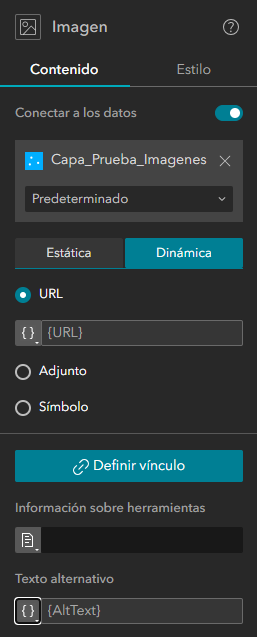

Is it feasible for you to add a separate field for the alt text in your table/feature class, in the same way that you have the URL for the image? I think this would be the easiest way for you to get what you are looking for. Then you could choose "Attribute" for the alt text and select that field, rather than calculating an expression. This worked with some test data that I created.
