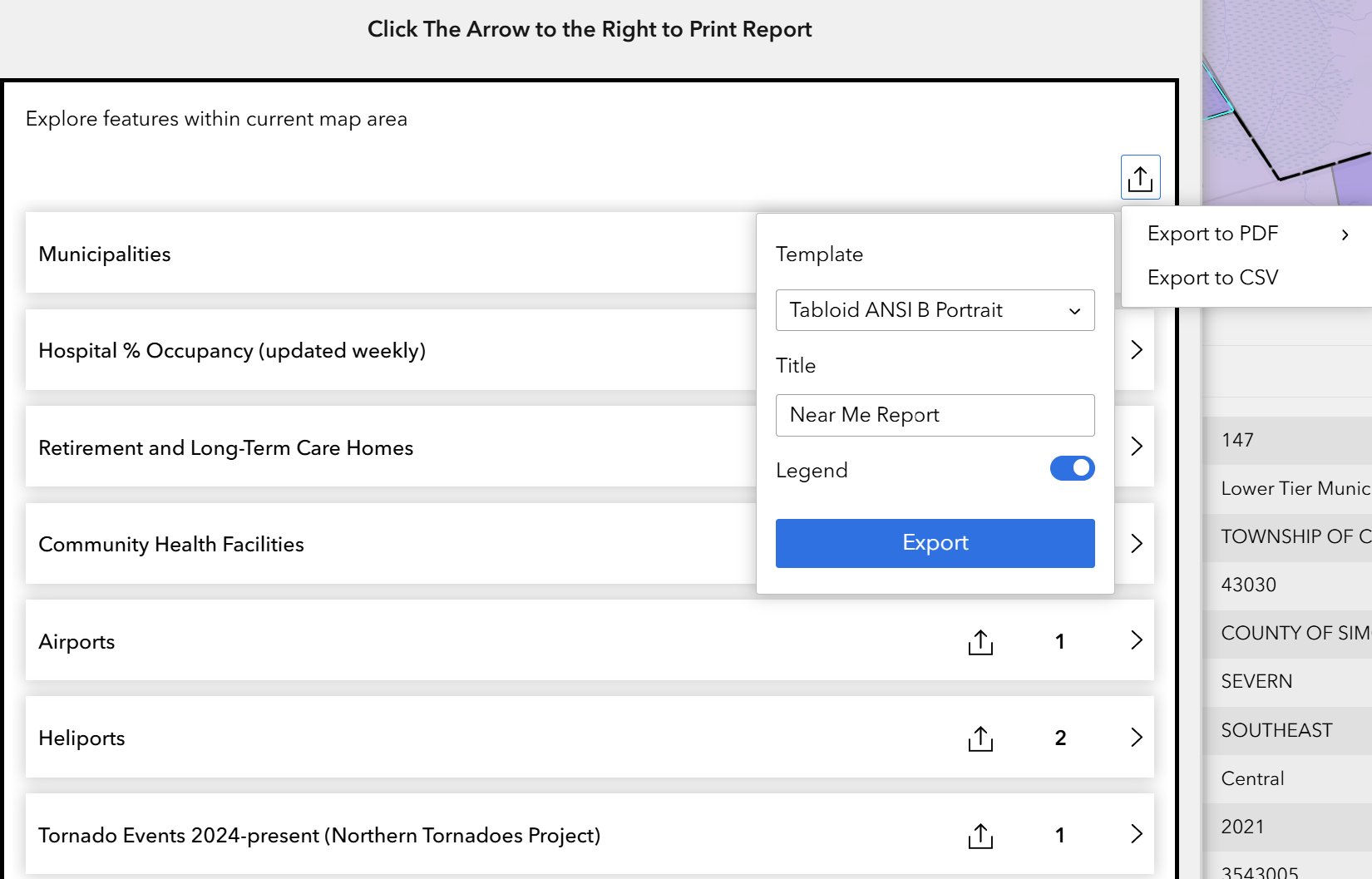

Hi
I am using the ArcGIS Online Experience Builder Near Me Widget and I love the widget.
When I am using the out of box "export to pdf" function, the legend is cutted off and doesn't show the entire legend.  Is there way to show the full legend?
If you tab through the resulting pdf in the web browser, the entire legend is actually there but it only shows it partially.
The print widget shows the map and legend perfectly.  I wish the near me report can integrate the print widget results (map and legend) with the tabular report from the near me report.
Also, when you export to pdf, the map extents zoom out automatically, is there a way to make it stay in the current extent?
Anybody know of short-term solutions?
