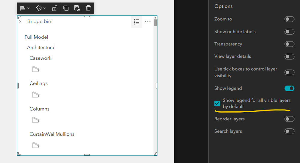

@RossFindlayCOC In the Map Layers widget, there is an option if you turn on the legend - "Show legend for all visible layers by default":
Is this something you are looking for?

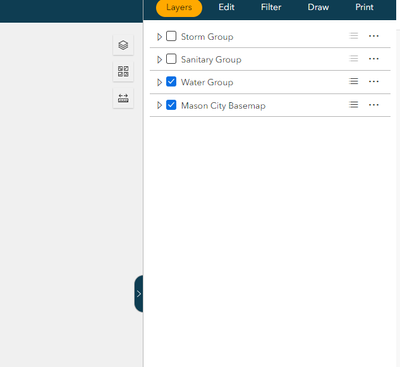

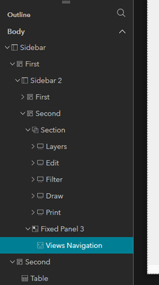

I use a section with a views navigation to keep it open upon loading.

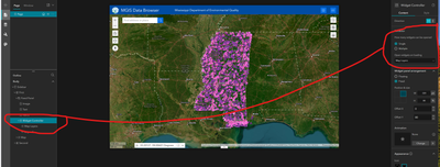

You can do it now using the Widget Controller, not the Map Layers Widget Properties.
