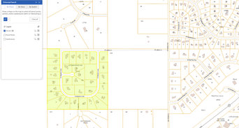

Hi,
Working with Experience Builder on ArcGIS Online.
Behavior Wanted:
We need users to be able to select two disconnected sections of land parcels and export their information to a CSV.
Problem:

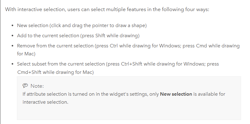

The experience builder documentation says the following for the select widget:

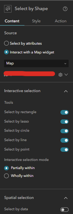

If I select the left set of parcels using an interactive selection lasso and then hold shift while lasso-ing the second set of parcels, only the new selection remains and I lose the first set of parcels. I do not have attribute selection turned on.

I was able to solve this by turning off the attribute selection parameter. Not sure why having it enabled disallows adding to your current selection.
