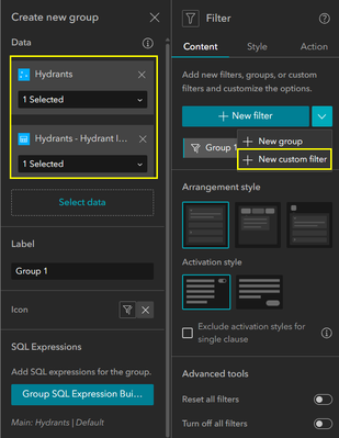

I have a layer with an ID field and a table that also has an ID field. They are both in the same web map, but the table is on its own. I want to use Experience Builder to filter and zoom the map based on the feature layer, but I’m not able to create a relationship to filter the table data like I can in the Dashboar

Hi @AppendArcPro,
Please use group filter. It was released in ArcGIS Online on February 2024 and on ArcGIS Enterprise 11.3.
If you are using a version prior to 11.3, you may use the latest developer edition to connect data in current Enterprise. This is a commonly used pattern for Enterprise users who can't migrate to the latest version of ArcGIS Enterprise but want to use the new features in Experience Builder.
