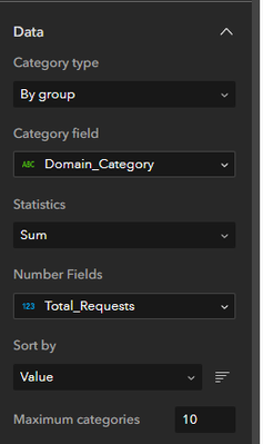

Hi there! I am having the same issue. I am noticing this in both Developer Edition (version  1.13) and in the AGOL version of Experience Builder. I am using the following layer to populate my bar chart:
https://dnrmaps.wi.gov/arcgis2/rest/services/FR_IFFRS/FR_RXBURN_DASHBOARD_WTM_EXT/MapServer/0
I would like for only 10 categories to be shown, but all the categories from the data are shown. I attached a screen capture.
Interestingly, when I create a bar chart with data from an AGOL-hosted feature layer, the maximum number of categories works as expected. So it only seems to be a problem with map services (and layers within them).
Thank you!
