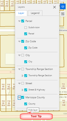

Hello,
is there an alternative to the "eye" symbol which is used to turn layers on and off?  I don't believe the current functionality is very intuitive at all, especially for a public audience.  The "tick boxes" in the WAB are much better in my opinion.
Thanks

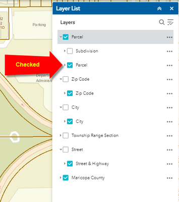

Can we take this one step closer to the Web AppBuilder version?
What symbol should I use to get the white checkmark against a blue background?
This makes it easier to see which layers have been turned on.

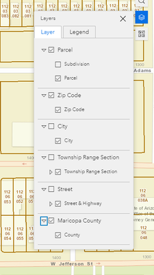

I guess you are looking for something a little more like this then:
.esri-icon-non-visible::before {
    content: "\e610"!important;
    color: #969696 !important;
.esri-icon-visible::before {
    content: "\e605"!important;
    background-color: #00b9d0;
    color: white!important;
DavidDas__GISP
Hi Robert,
Yes, that did the trick.
This looks perfect.
You have a solution for everything!
I learned something new today from your clever code snippet how one can change the background and foreground color. I had no clue that this can be done.
I agree ESRI should give us the option to select these icons and set the colors while configuring the Layer/List Widget in the AGOL edition of the Experience Builder.
