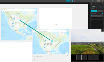

3. Use an Embed widget - since the URLs are stored as one field inside the data, representing the whole survey, you could utilize dynamic URL methods and configure the {URL} field. In this way, the embed widget will update each time you click on the feature. Something similar like this:

4. Use the Embed widget to embed the survey URL, and add the GlobalID as the dynamic part. Something like this:
https://survey123.arcgis.com/share/<yoursurveyitemID>?mode=edit&globalid={GlobalID}
