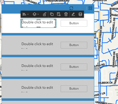

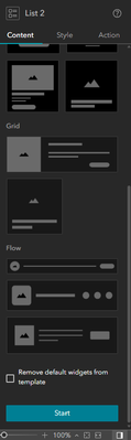

Another question, inside of the list, which widget should i use? this is default.
JeffreyThompson2
MVP Frequent Contributor
What Template you use is up to you and your data. Use Remove Default Widgets From Template to start from scratch.
