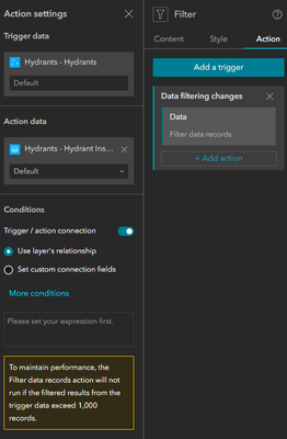

Hi @Michael_Rehberg ,
Some message actions support the use of relationships, such as "Data filtering changes - Data - Filter data records", though there are some limitations on the number of trigger data records.
You can find all message actions that support relationship at https://doc.arcgis.com/en/experience-builder/latest/configure-widgets/action-triggers.htm#GUID-2D036...
Please let me know if you have other questions.
