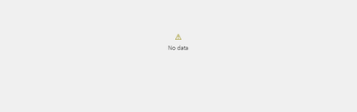

The selected data is triggered from another widget.When the experience starts there is no selected data and the users see this instead:
Is it possible to change this text and icon to something else? Or is it possible to hide it when there is no selected data present?

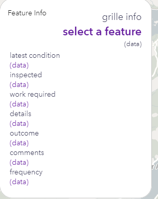

If you create your list using your own cards with defined test fields, you can "alias" the expression to say (no data) or Select a Feature. Example below.

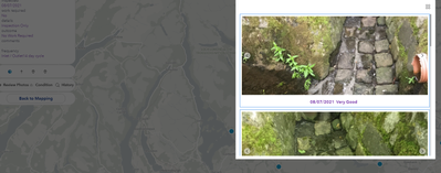

Alternatively , you could embed your list into a window - this means the user selects the data using the associated widget you have, then clicks an icon to open the resulting list. I do this to view inspection history photos against a selected feature, rather than having a list of everything. Again, sort of visual below.
