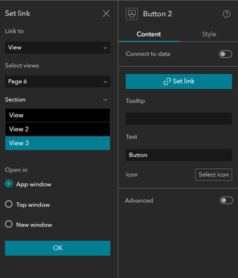

Hi @RaynerCastro ,
You can set the link to a view instead of a page:
Regards,
