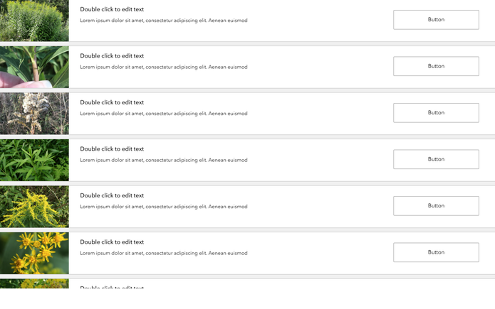

I have a list widget with dynamic images and text shown using a connected dataset containing the image URLs and text.
What I want to do now is link the images to a view within the Experience Builder app, so that clicking each image opens up a different View.
If I go to the first image>Set Link I can choose to link to a View, but this applies the same View to all 5 other images in the list widget. But I want it to be dynamic and each link to a different View.

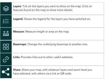

Hi @NicoleJohnson, thank you for the response. Each view is different. Actually I realised because the map viewer is public I can just share it on here!
https://experience.arcgis.com/experience/f7af4d60802d4539b59f12f2ba995d64/
What I want to do is make the items in the About section List (below) clickable to open each of the corresponding vies. E.g. Click on the Layers icon below and it opens the corresponding Layers view (from the top toolbar):

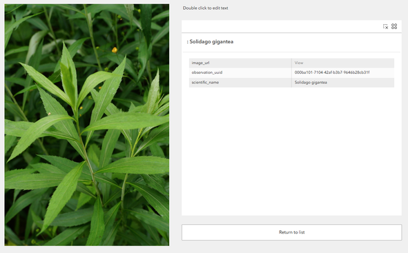

Just checking: are you actually wanting to make each view different (beyond just showing dynamic data)? Or would sending the selected data to the view work?
If you just want to show dynamic data, you could put two views inside a section: 1) the list, and 2) whatever dynamic data you want to show for the selection. Have a button in the list view list widget link to the view that has the dynamic data (or just use your image widget).
Then on your dynamic view, make sure you're always using the "selected" data view:
Then when you use the list to see the dynamic view, that record's data will be selected:

DebSF
@NicoleJohnson That's a great point, I was focusing on the list widget as that's the way I set it up originally, but actually the structure using rows works just as well, plus lets me link the images to the views.
Thanks for your help!
