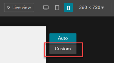

Hi, you can enable custom layout for small screen devices and then adjust the table height accordingly.

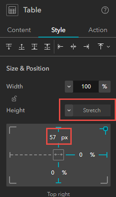

Hi @BuffaloCoWI ,
This is because the filter widget uses an auto height in pixels. Can you try updating the table widget's height to 'Stretch' to see if it resolves the issue?

Encountering either a bug or a misplaced layout where even if I start altering in Custom Layout view for Tablet or Mobile, it will effect the Desktop view as well. Any ideas?
ShengdiZhang
Hi @JonnyRogers1, you can set different layouts when enabling custom layout, but the widget settings (on the Content setting panel) will be synchronized across all screen devices.
As a workaround, you can duplicate the widget on Tablet or Mobile, and move the original widget to the pending list.
