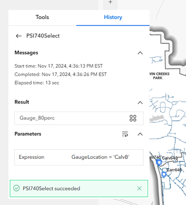

Hi there,
I am struggling with running some geoprocessing services.
When I finally get something to work, it won't appear in the map. How do I get this map to show up in app?
Please and thanks.

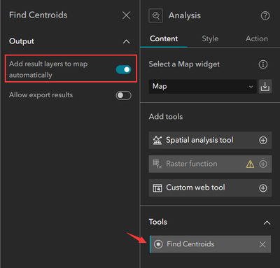

Hi @Rick_O_Hara,
You could click the tool then toggle on "Add result layers to map automatically".

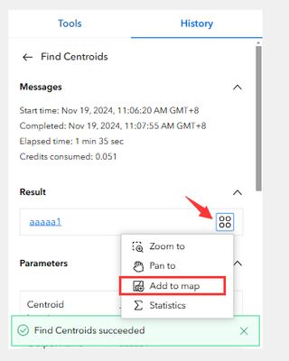

Or in the history tab, click data action -> Add to map.

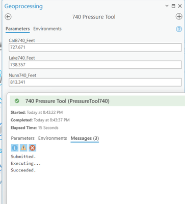

@Ke_Xu
I have tried all kinds of work arounds. If there is a raster layer/process in the geoprocessing tool, it will not work. I just get an empty layer. It will work in arcpro as model, but if I publish it, it will not provide a layer in an app. It will not work if I run the tool from the server connection in arcpro. It just gives a blank layer with no data.
I've tried everything I can see to do.
The model will work. The geoprocessing tool will not. If I create a different geoprocessing tool with a raster in it, it will not work.
