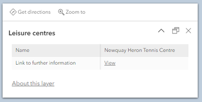

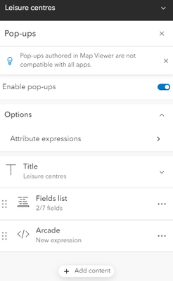

The link to the overview page only works for signed-in users, but for what it's worth, this is what I've done. In the web map pop-up configuration for each layer, I've added an Arcade expression:
var theMetadata = "<a href='URL to the overview page in AGOL'>About this layer</a>";
return {
  type : 'text',
  text : theMetadata
I'm going to add an Idea - it would be so useful just to be able to pull up the summary or description text in a hover over link.
