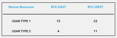

I am new to Experience builder.  I am attempting to display a table of Counts from a Feature Layer similar to the Photo Attached.  Basically  I want to look at the Data and give a Total Count of the Items that meet those Types.  How do I build a table that dynamically changes base on the inputs to the layer?

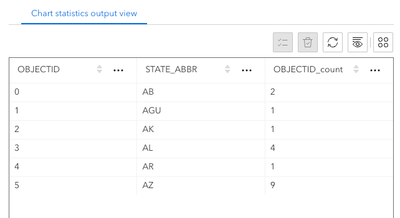

1. Add a Chart widget to calculate the statistics. Use the chart output data as the data source of the table sheets.
  • Add a chart and select Statistics as Count
  • Create a new sheet in the Table widget, and select Chart statistics output view
It will give you a table of counts from selected categories in the Chart widget. But the field name cannot be customized and it can only show one field count in each sheet.

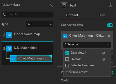

2. Create data views with predefined filters and use Dynamic content in the Text widget.

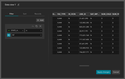

  • Go to the data you would like to calculate statistics and create separate data viewsScreenshot 2023-10-07 at 17.58.28.png
  • Add Text widgets and connect to the data views

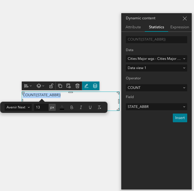

  • Use Dynamic content to calculate the count

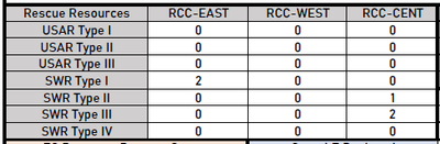

susic
by
Thanks, Number 2 seems to be a great option.  Just to confirm, I would need 21 Views to accomplish the below chart.
Shen_Zhang
Based on the provided table, each value necessitates a view, resulting in a total of 21 views. Additionally, creating data views while connecting data can save time as it eliminates the need to do so in advance on the Data tab.
