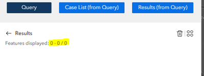

I am having an issue with the Query widget (spatial filtering)

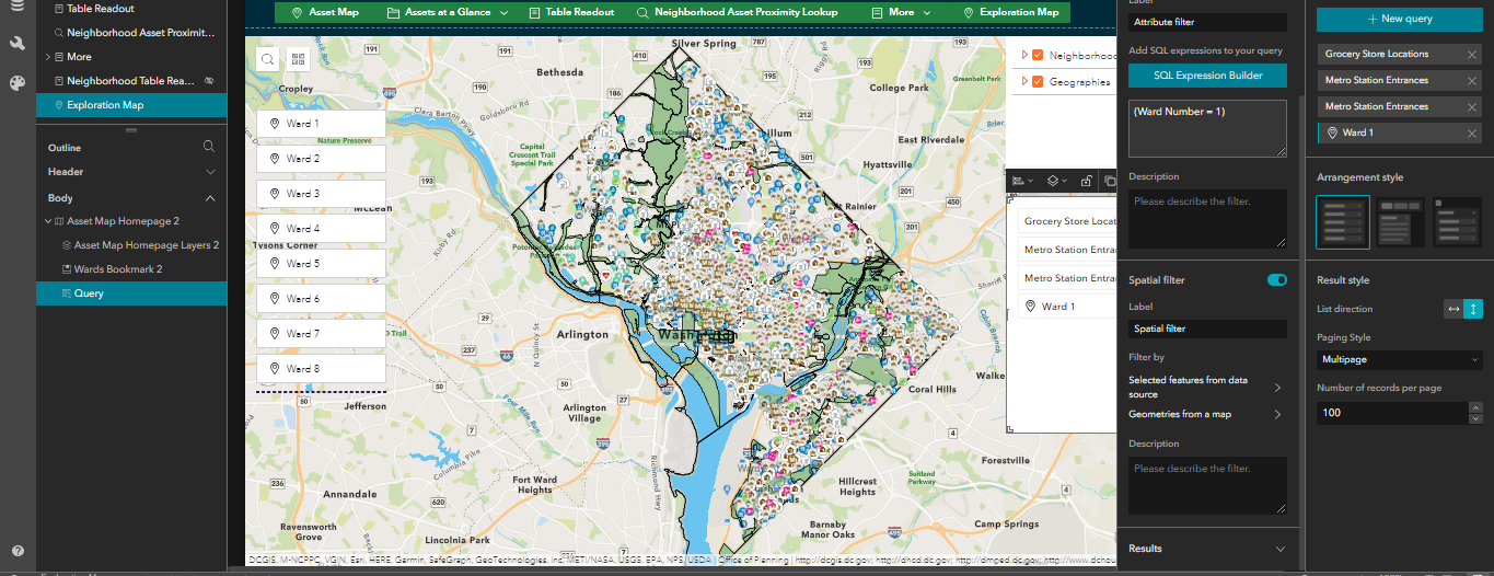

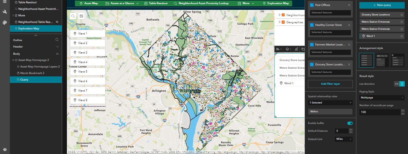

I'm looking to filter certain fields that are within a subset of a polygon file that I have
But even when I put in selected features from data source I get 0 results (see first image)
Any help or advice would be appreciated! Not sure I'm doing something wrong on my end or not @Jianxia

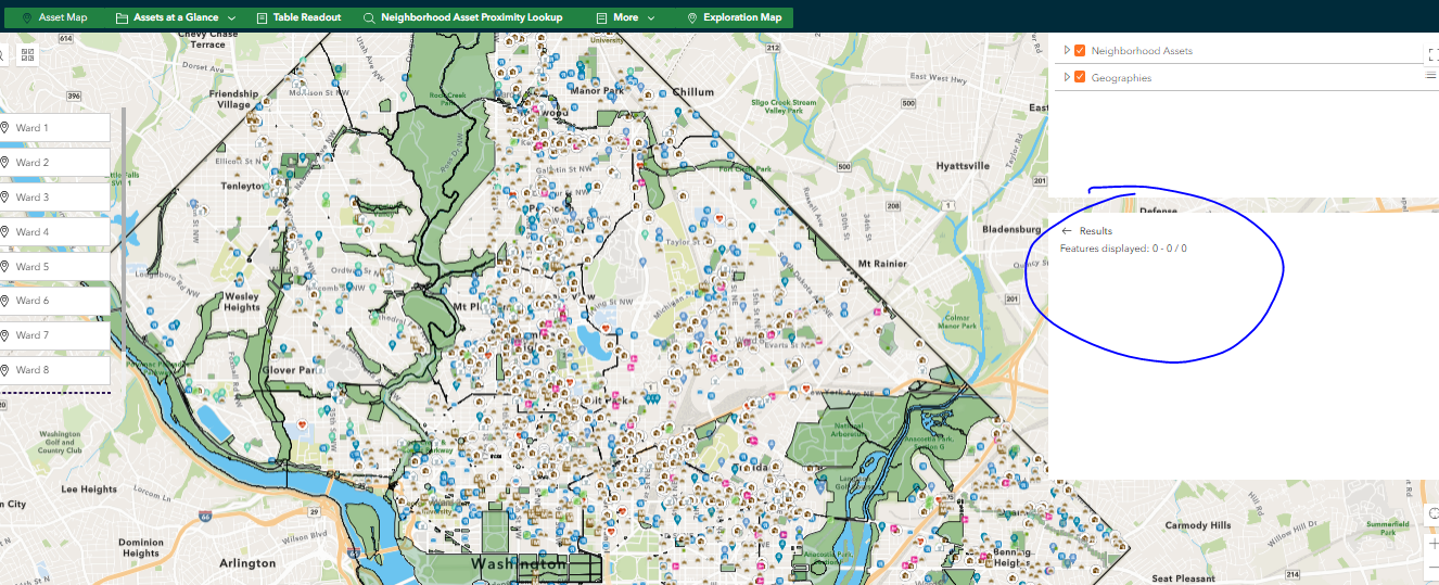

I get this same issue - were you able to figure it out? The records are there if you export, and I can get them to show up in a list view too...but not the results of the query tool. Also weird but I see them in Live Mode of EB editor but not in preview/published version.
