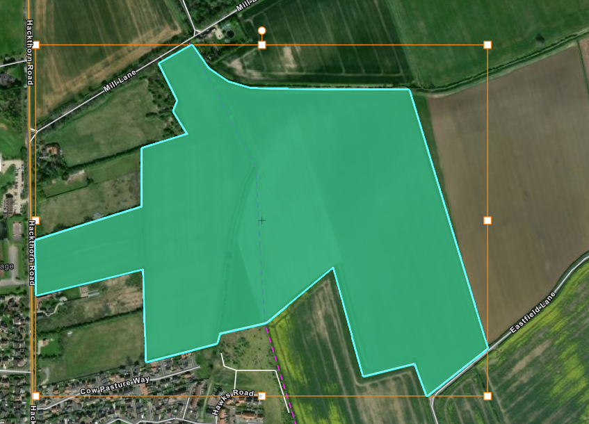

Hi all,
Since the AGO Feb update i'm having issues with my editing capabilities. I have a EB app which we use to edit daily and today it has been very tempermental and won't allow me to unselect a feature once edited. Also if I search using the configured search bar and it then selects a polygon, it keeps flagging up editing error/confirmation boxes when i'm not even in edit mode.
Is anyone ese experiencing similar? I've checked all our config and all seems fine, nothing has changed from yesterday when it worked perfectly.
This is an exampe of what I can't unselect - it won't let me edit anything else or get pop-up info on any other layer.

@James_Shreeve Please are you able to share a recording of the behavior with your workflow steps? If you have an app example you can share are well that would be most helpful, thank you!
James_Shreeve
Hi Alix, thanks for your reply. I can't really share the workflow, as the data (other than the polygon shape) is sensitive so wouldn't feel comfortbale putting it on here. I'm currently in discussion with ESRI support also who have taken a screen recording of the workflow and took further details in the hope of finding out the issue. There have been changes to the Edit EB widget overnight, which i'm assuming is linked.
