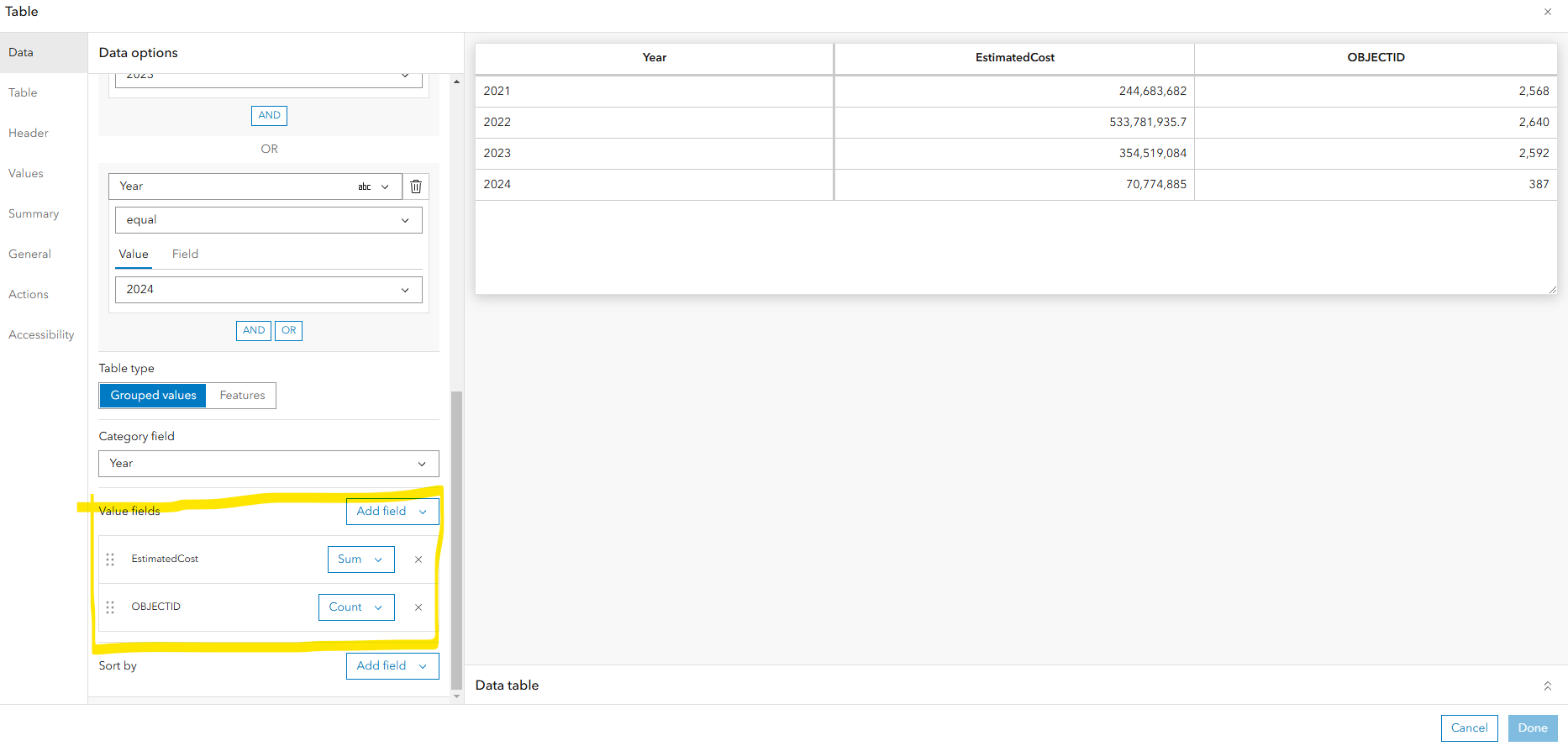

I wanted to ask if the Table Widget in ArcGIS Experience Builder has a built-in summary (Group By) feature. In the ArcGIS Dashboard app, when adding a table, there is a "Grouped Values" table type option available, which automatically generates summary values (please refer to the attached screenshot).
However, I am unable to find a similar option in the Experience Builder Table Widget, which has made it quite challenging to display summarized data effectively.

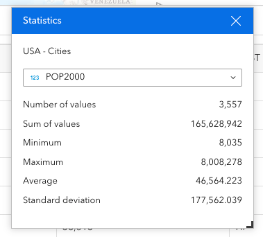

Hi @hnam, have you ever tried the Statistics data action? The summary is not supported in table but you can leverage the statistics action to view some certain indicators.
