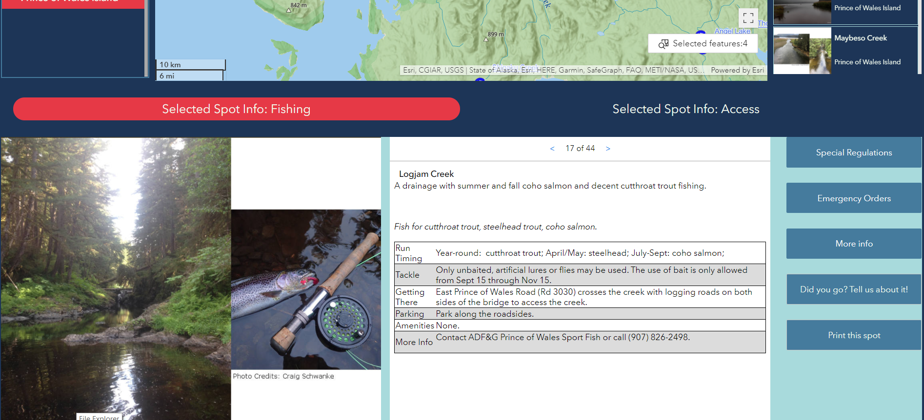

I have two primary components in a scrollable Experience Builder that provide first, a map based tour of locations, and second, more information and links below. I'm wanting to direct users attention to the information below the map via a Button widget within the sites list.

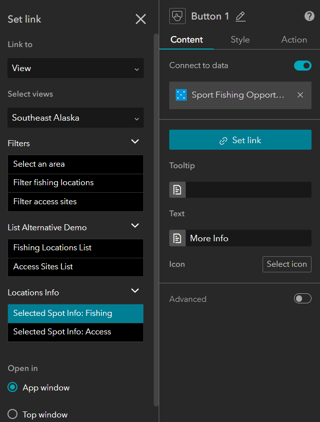

I tried to set the button link to a view within the app window initially, since the content below the map is a view. This did nothing. When I changed the settings to open in a new window, it simply re-opens the EB in a new window, with the same initial view from the top of the page.
Is there a way to get the Button widget to jump to a section of the scrollable template?

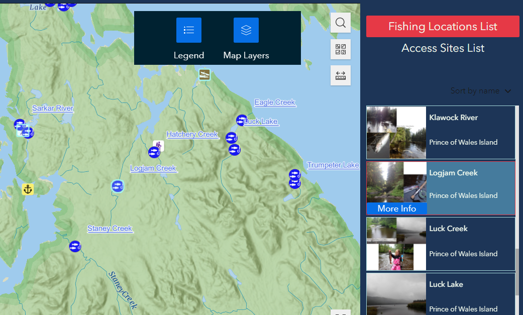

In other words (and pictures), I want users to be able to click the 'More Info' button from their selected site in the List widget...
... and jump to the more info view below the map:
Here are the current settings that aren't accomplishing what I'm needing:
I have a sneaking suspicion that I'd have to turn the more info section into a separate page, but that really isn't the preferred route of action. It seems silly because opening a new page is a separate setting... so if the settings to link to a view and to a page work the same, why offer them separately as configurable options? Many thanks for any help!

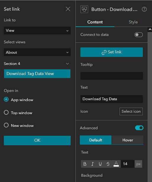

I'm trying to link a button on page 1 to a section view on a different page (scrolling) and if I understand correct this link even though I specified the view it links to the page top for the scrolling page instead of the section/view in the middle of the page. Is linking directly to the section/view mid-page not possible? I find it confusing if folks click the button, in this case to download data and then taken to the top of another page instead of the download section.
Hopefully I'm just missing a setting.

I'm currently using Experience Builder and can't get this to work; I've linked to a block on another [scrolling] page and it automatically links to the top of the page instead. I can't figure out what I'm doing wrong. Is it still available in Experience Builder?

@wmboulder Currently we do not support the setting of linking to blocks on other pages. Could you elaborate more on how you configured that way?
