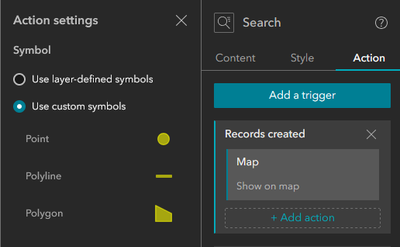

I have a Records Created action set up to show results.

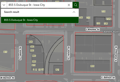

But point feature searches don't show any symbols at all.  *Note the result is in the lower right corner of the image but there isn't any highlight, etc.  The Record selection changes > Map > Zoom to action works though.

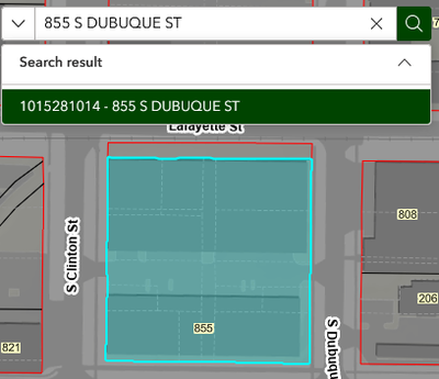

And if I execute a polygon search I see the default cyan symbol and not what's in the custom symbols settings above.
