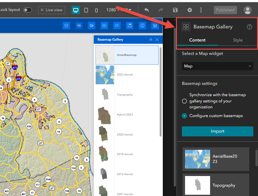

I am working in Experience Builder Developer Edition 1.14. What I hope to achieve is when a user selects a specific Aerial basemap, in the 'Basemap Gallery' widget, it triggers an action to turn off the City Boundary layer, in the 'Maps Layer' widget. Currently, it does not appear that 'Action' is an option, when configuring the 'Basemap Gallery' widget.
Any help would be greatly appreciated. Thanks.

Since you are using Developer Edition, you can build a custom widget that uses the reactiveUtils.watch() method to see which basemap is loaded turn off your City Boundary layer.

Thanks for the feedback. I was hoping to not to create from scratch, but seems that is the way to go. I have not created a new widget, for Experience Builder, yet. I will look into using the method you recommend. Hopefully I can figure it out. If not, you may be hearing from me.
