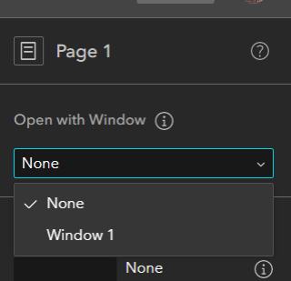

Is this possible?
I'd like a splash window for each of my three pages. End users will be on laptops, so real estate is at a minimum. There's introduction text and video we want to share with them, but once they've viewed it, they won't need it again. I thought a splash page would be good for this.
My fallback is a button that opens a window.

It is possible, and a feature we use for the same reasons you want to. In the page's settings, there is an option for Open with Window. This takes a window you have configured and treats it like a splash window for just that page.

Thanks @jcarlson !
