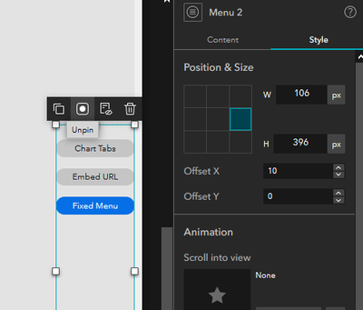

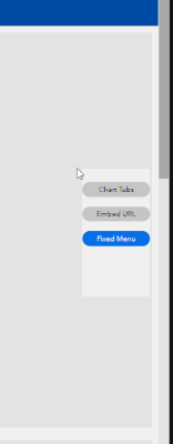

Another option is to use the Pin setting in a widget. For example, I'll set my menu widget to be pinned to the right-center position.
It won't be obvious in the editing view, but when you preview your experience, it should behave like you expect.
- Josh Carlson
Kendall County GIS
lst
Brilliant! This is exactly what I was looking for. I'm new to the system and was sure it would be something simple I was missing.
