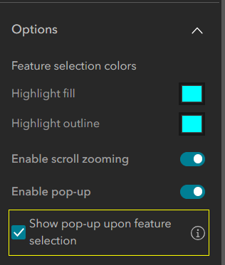

What if we replace the Feature Info with the Table widget? Then configure the "Show pop-up upon feature selection" in the Settings of the Map widget. When users select a record in the Table, they can view the feature's information.

JamieVergano
Hey! Thanks so much for the suggestion. Are users able to select more than one record from a table? If so, I'll give that a try.
JeffreyThompson2
MVP Frequent Contributor
Yes, there are checkboxes in the Table that allows for the selection of multiple records.
GIS Developer
City of Arlington, Texas
JamieVergano
It looks like this may work, but I don't see the checkboxes you referred to @JeffreyThompson2
Edit: I found it! Thanks so much @Ke_Xu and @JeffreyThompson2.
