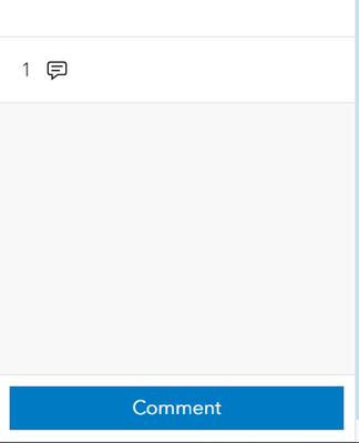

Hi, @sophered Once a report has a comment to it, it appears at the bottom like shown in the image below.  User can learn more about the comment but clicking on the arrow.
In the screenshot, I don't see the comments but looks like there's one comment submitted. Could you look into how its configured? If you notice a bug, let me know or please submit a bug through esri support.

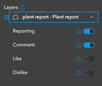

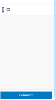

This may or may not be a bug. I have the commenting toggled on, however I dont have it toggled for likes and dislikes (because it may not be applicable for what I need). It allows me to submit comments but not view them.
It does not seem to give me any option to click on the comment symbol and it does not automatically show comments.

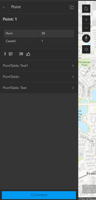

@sophered You could check the table in map viewer or rest endpoint to make sure the comments are added.  I think there is something wrong with the way relationship is set-up and thats why its not showing up on the comments section, but it appears to be added. If you can share the map and app I can look into it.

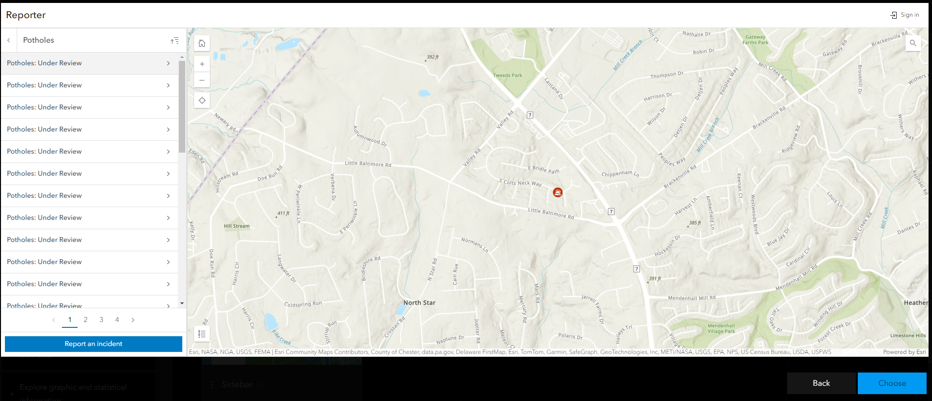

I have been looking into it! I'm not entirely sure if I like how it adds new features though. Particularly the "double map" that you can see in the image (map in survey + map in exb). I would like it to interact with the main map instead of having them add a new record within the survey. Is there a way to work around this possibly?
