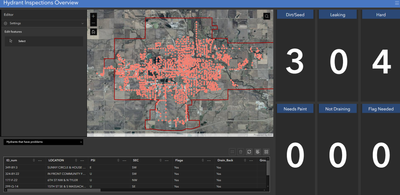

JArnone_PIT
I think it's something like this, and trying to figure out how to best do this in EB as well....

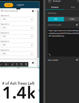

@Laura So you're making a Dashboard with just an Indicator and then using the Embed Widget in Experience Builder to make your own Indicator Widget? That is such a stupidly fun hack and I mean that in the nicest way. Could you please write it up for the Tips and Tricks Board?

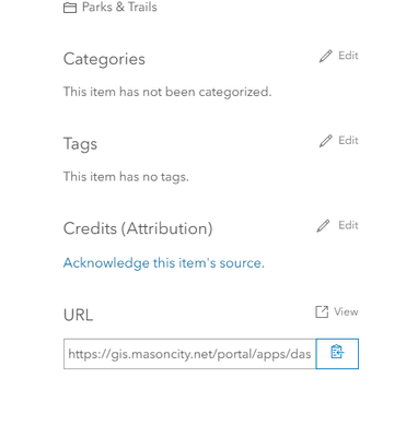

How exactly do you get the URL for the indicator itself?
Laura
by MVP Regular Contributor
Go to the dashboard item detail page and scroll to the bottom and copy that URL.
