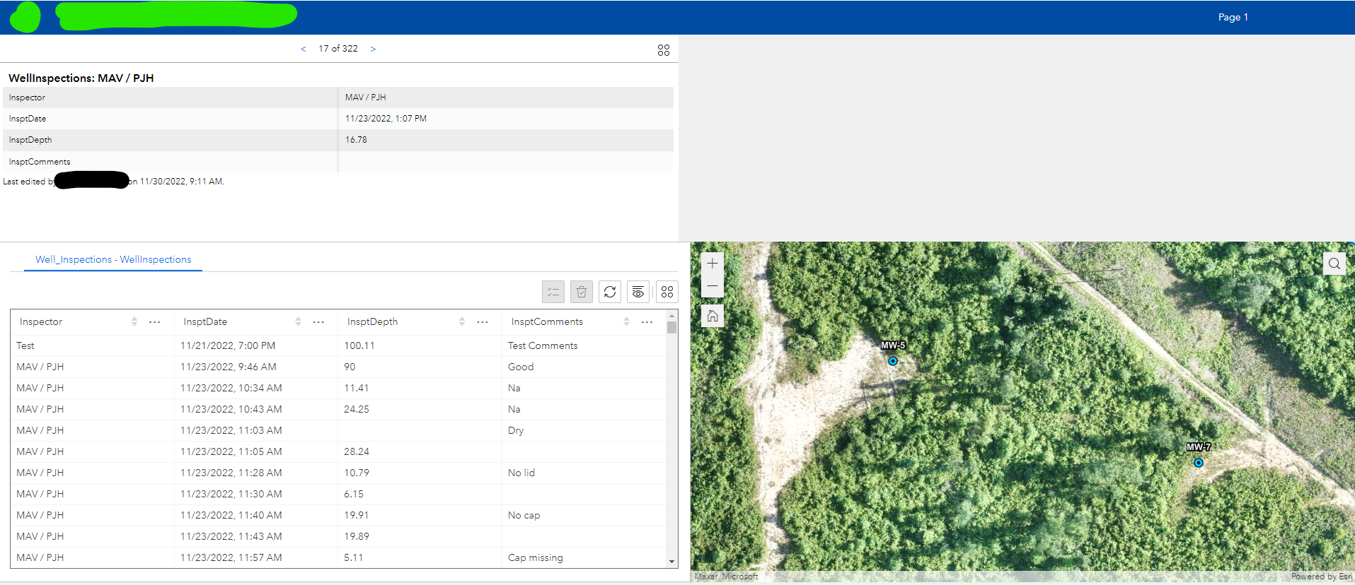

I am trying to create an experience of inspections for wells that I have.  Inspections are quarterly/monthly and I want to be able to click on a feature and have it filter in the table to the left. However I currently can click a record and it will flash the feature but I would much rather have the reverse were I can click the well feature and list all 20+ inspections that have been done.  Any ideas would be highly appreciated.  Thanks!
