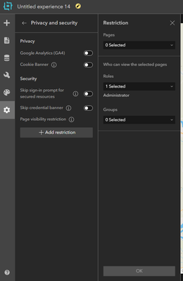

There is not a mechanism for restricting access at the Widget level, but you can restrict a Page by going to General Settings > Privacy and Security > Page Visibility Restriction.
