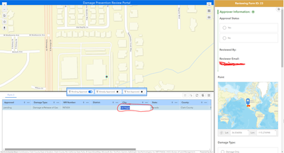

Hi,
I'm trying to incorporate a table widget strictly for selection purposes, however, if you double click on a cell it allows you the edit the layer that it is connected to. I do not want people to edit the data by double-clicking the data in the table. I want them to select the record using the table, and then submitting their edits in a survey widget.
How do I go about making the contents in the table widget to read-only/non-editable?

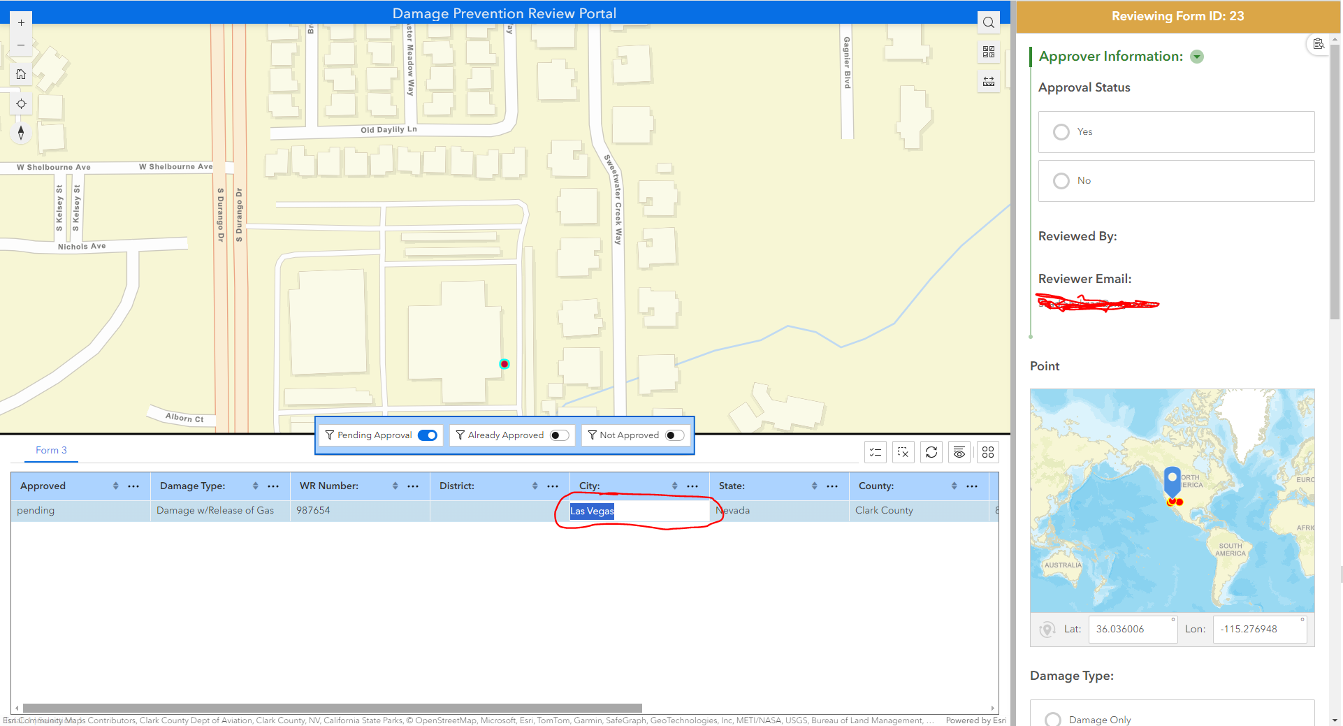

Hi Shen,
I appreciate your response. I changed the setting to Customized, and ensured that the Allow Editing checkbox was unchecked. But it did not change the behavior of the table, it still allows the user to double-click a cell and edit the contents within the table.
