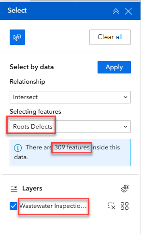

With Select Widget, I can pass all records from the point layer. But 0 records are returned when I run it. I am pulling my hair off and can't figure out how to get this simple function to work.
Below is the result of running select widget. The Roots Defects layer is a point layer and has 309 features in it. The Wastewater Inspection Run Layer is the line layer. I am trying to return inspection runs that have the roots defects points on top of them.

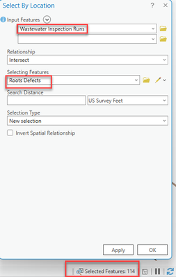

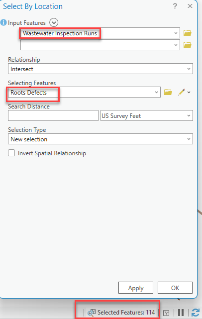

When I run Select By Location in Pro using the exact same layers, I got 114 records returned. This Pro project is what I used to published the layers.

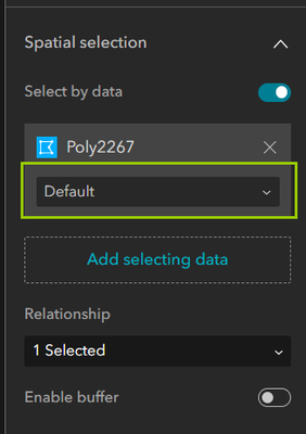

I couldn't reproduce this issue on Enterprise 11.3. Could you share the webmap for me?
Could you try try the Default view and check if there is any result returned?

Thanks for looking into this. Our portal is behind our firewall unfortunately. I do have it set to Default, so that's not the issue. The line feature has over 100,000 records. Do you think that could be an issue?
