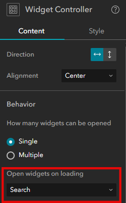

The cause of this problem is that the search widget is placed inside a controller. The search widget does not load when the page loads.
We can improve this behavior to ensure that the widget is loaded by default when the widget id is in the URL parameter. However, there may be conflicts with other functionality, so we need to discuss this further.
A simple workaround is to select the search widget in the controller - Open widgets on loading:
Using the data source selection in the URL parameter will make the map zoom work. However, it will not display the Parcel ID information in the URL. Like this URL: https://experience.arcgis.com/experience/a2380710835a4b8bb9fd9021adea8bd9#data_s=id%3AdataSource_1-1...
Please let me know if you have any other questions.
