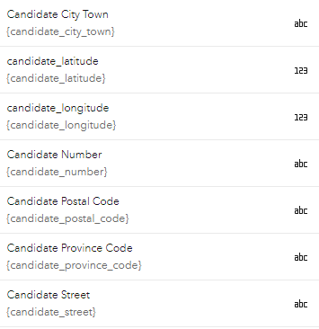

I have configured the fields in the Map Viewer, however the table widget in the Experience builder doesn't honor my configuration.
Map Viewer configuration
 Experience Builder table
Is there anyway to make the table follow my Map Viewer configuration, or to configure the column names within the Experience Builder?

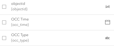

I checked ArcGIS Online and there it seems to be working as it should.
Map Viewer:
Experience Builder:
Would it be safe to assume that the latest versions of ArcGIS Enterprise would have a similar behavior?
