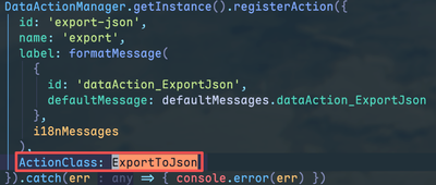

ShengdiZhang
Hi @MadhubalaK ,
Please try using ActionClass instead of uri.
Regards,
Shengdi

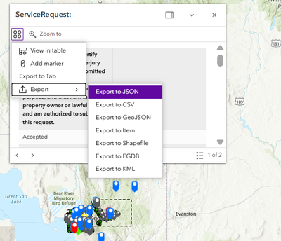

MadhubalaK
Hi @ShengdiZhang , Thank you for your reply.
I have added the ActionClass instead of the URI. Now, the Export to Tab option appears in the existing Action List.
However, I want to add the Export to Tab option to the already existing Export Options instead of the general Action List.
  • I want to add it directly into the Export Options dropdown/panel, so that users can see it alongside the other export choices.
  • Could you guide me on how to integrate the ActionClass specifically into the Export Options rather than the general Actions?

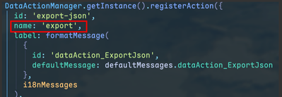

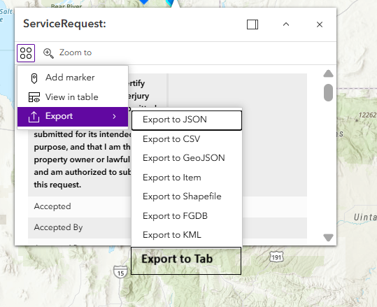

ShengdiZhang
Hi, when registering the action, please set the name to ‘export’.
