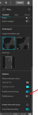

Try disabling popups in the Map Widget Settings. I think this should prevent changing the selection on a map click and you already have a Feature Info Widget so having the same information in a popup is redundant and makes your display more cluttered than necessary.
