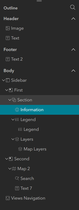

I created an Experience Builder app using the tab template. The template comes with a pre-made Section with several views, including Legend and Map Layer views. I am trying to add another view that shows basic information about the app/organization using a text widget. I was able to add the view no problem, but I cannot figure out how to add a widget to the view labeled Information.
Here is the current page setup:

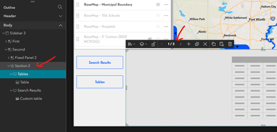

First of all, since you started with a Template. You probably need to unlock the layout. It's in the top bar by the screen size picker.
Navigating to the correct View in a Section can be a little tricky. Here's what I think may be the easiest way to do it. In the Page Sidebar, click on the Section. This should bring up a black bar over the Section. Now use the arrow keys on the black bar to get to the right View.
Once the View is selected, you should be able to drop in any widget you would like.

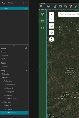

When I click on the sidebar on the main part of the screen, it activates the Views Navigation rather than the Section and I cannot figure out how to activate it that way. When I click on the Section under the Page Sidebar, it doesn't activate the black bar you mentioned.
