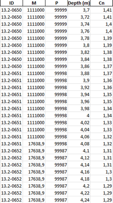

My table looks like this:
I want to create a scatter plot that displays all rows with the selected ID in the map, using the columns Depth and Cn. Additionally, it would be helpful to know how to achieve the same result directly from the table.

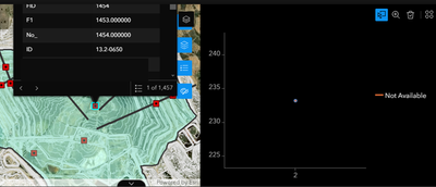

Right now, the chart only shows one element:

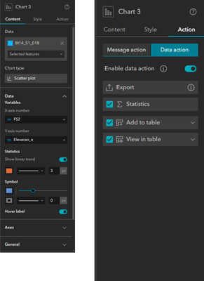

Yes, I'm using the 'selected feature' because I want to select a point on the map and then display a scatter plot by filtering the table to show only the elements with the selected 'ID' from the map. Below is my chart configuration.

With "Selected feature" view as chart input, when you are selecting a point on the map, it also filters the chart input data, so you will only see on point on scatter plot, which is as expected.
If I am understanding correctly, you just want to filter Table by "ID" of the selected feature, but do not want to filter the scatter plot? If so, you can use a separate data view create from the original data source (which remains all data), and use that as input of the chart. Then you will set message action in Map to trigger selection to filter Table.
