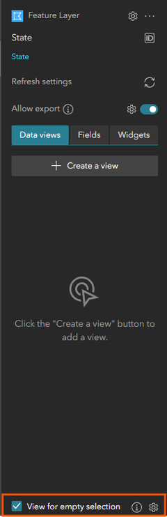

Blank dashboard problem: You can enable a view for an empty selection. This makes it so the user sees something before having to make a selection. You can set this through the Data tab:

I did give your first suggestion a try for the "Blank Dashboard Problem". I am almost certain this is user error on my end, but I couldn't get it to work. After I enabled the "View for empty selection" on the data source, the embedded dashboard still wouldn't appear on the initial load. The entire widget just showed up as a blank space. It wasn't just a map failing to load; the entire dashboard was missing.
Here are a few screenshots of my configuration and what I was seeing:
