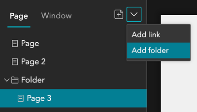

@JoseBarrios1 Well, the menu is used for page directing, and I assume you have a valid 'Help' page here.
If you do not want the parent to be clicked and redirected, using a folder might help with your case:
