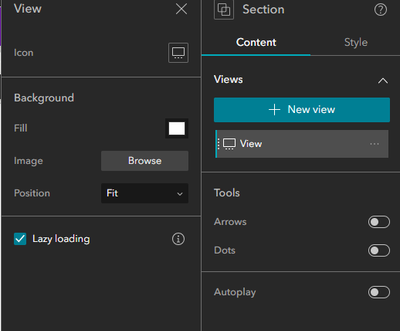

The Section Widget is a built-in widget that allows you to create mini-pages, called Views, within your Page. You can put multiple Map Widgets within the same Section Widget on different Views and set up a View Navigation Widget or a series of Button Widgets to switch between your maps. The Views have an option called Lazy Loading. Using this will prevent the View from loading into memory before the end-user requests it.

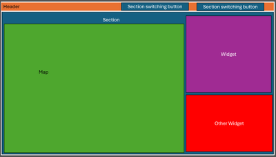

I have a Section with two views. Each view has a map widget using different web maps. I'd like the "Map Layer" widget  or other widgets such as Legend Widget, Filter widget to switch data source automatically  to point to the data layers in the active view.
I am very interested in this approach: having your Widgets change to match the Maps. Can you please provide more information?

I drew a quick picture of what this kind of layout might look like. Hopefully, this explains the concept.
