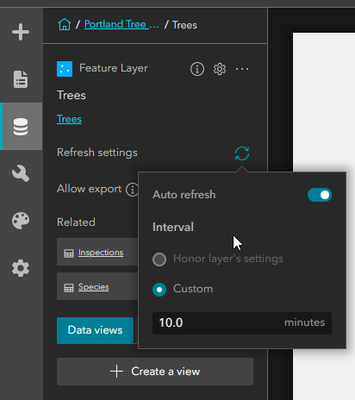

Allen_Zhang
Try setting up "auto refresh" for that data layer?

Allen_Zhang
I'm not familiar with a Steam Layer.
This "auto refresh" won't refresh the whole page, only the widgets (such as a map or a table) will reload the data with "auto refresh" enabled.
Is the widgets reloading data affect the Steam Layer's pending transactions?
